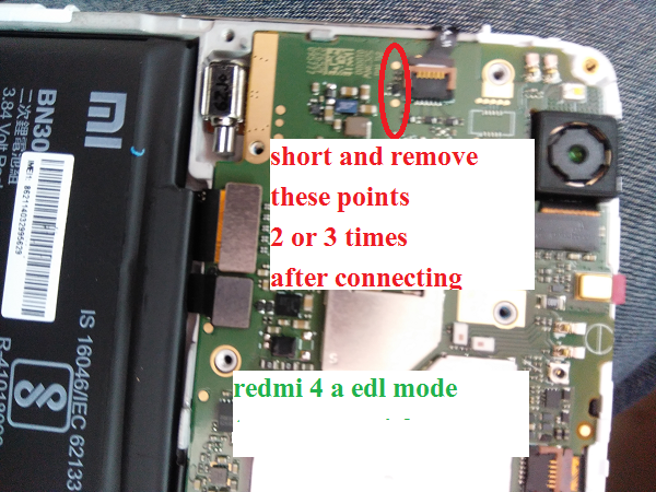

xiaomi redmi 4a mi account remove 1 click edl mode
1 short these points

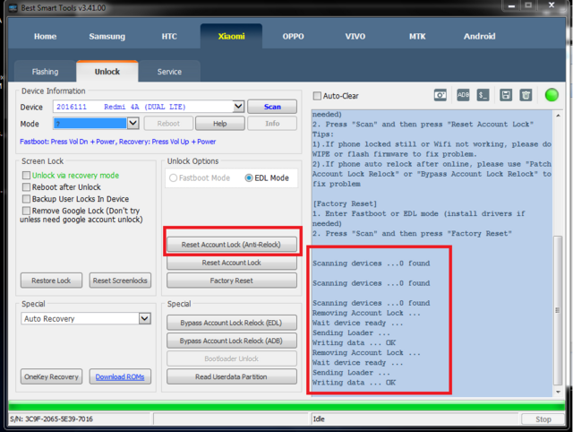

2 open bst dongle select mi 4a models and click reset account lock anti relock
Code:
needed)
2. Press "Scan" and then press "Reset Account Lock"
Tips:
1).If phone locked still or Wifi not working, please do WIPE or flash firmware to fix problem.
2).If phone auto relock after online, please use "Patch Account Lock Relock" or "Bypass Account Lock Relock" to fix problem
[Factory Reset]
1. Enter Fastboot or EDL mode (install drivers if needed)
2. Press "Scan" and then press "Factory Reset"
Scanning devices ...0 found
Removing Account Lock ...
Wait device ready ...
Sending Loader ...
Writing data ... OK
Sending Loader ...
Writing data ... OK
xiaomi redmi 4a mi account remove done
